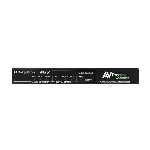

I know you now have a working solution, but a different client was having a related issue with an HDMI audio extractor to toslink. I explained to them that many HDMI audio extractors have terrible problems (crazy high jitter, wandering sample rates, etc.) so they went on a search for a high-end audio extractor. They told me they found this one and it’s been working great in their system with no lip-sync issues (in video mode).
I have not personally tested this, but the installer is a professional and reported great success with this.
How about this HDMI digital audio extractor?
The AVPro unit can be found on EBay for much better than listed MRSP. My system is working well enough right now to not want another wallwart SMPS, and black box, and extra cable, in the rack.
The only way to know if an HDMI audio extractor will work well is to simply try it. On paper, they should all be good. In practice, it’s a very different story. I went through 3 of them at home years ago before giving up. I brought them into the office and measured the output, and we were shocked at how terrible they were. It seems these more advanced ones at least have 48kHz at the right frequency instead of wandering.
At home I use the toslink output of my Samsung TV and it’s been 100% for years.
