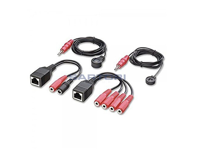

Another way, cheaper but also not that elegant (even if it works) is to buy and “IR extender on LAN cable” and this is what you have to type in google to find the availability of products in your area.
An example is this one:
As you can see there is a transmitter and then a receiver with 4 outputs in this case, and you’ll just need one. Beetween them you have to run a CAT5e/6e cable of a maximum lenght of 450m (roughly 1476,38 feet, I guess enough for you application :smiley: ).
The price here in Europe is almost 70 Euro, so you should be able to spend the same in your Country.
In this way you’ll have to point the MSB remote there you’ll place the transmitter and the volume will change accordingly.
