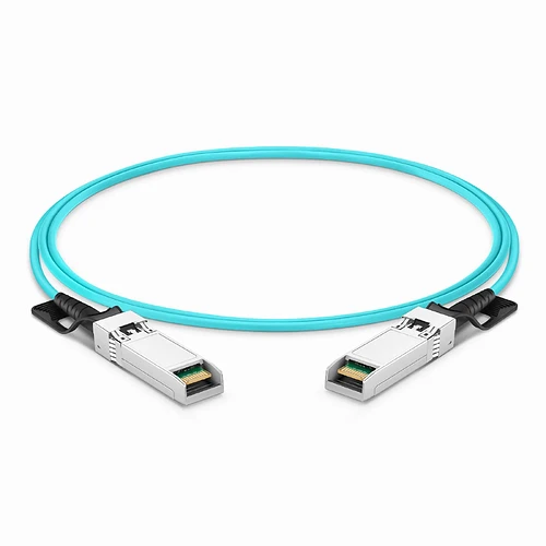

I went from 10 feet to 16 feet using the recommended AOC cables found on the MSB support page:
I will try the previous cable and let you know. Is the AOC cable directional? Both connectors looked identical so I assumed it was not directional.
2 m Generic is correct. The difference between 10ft and 16 ft is nothing. We have people using them at 35 ft and more. AOC should be good for hundreds of feet with no losses.
Let me know if going back to the shorter length correct, the problem. If so, I think it is not the length. Maybe the 16 foot version was damaged somehow. If the single fiber cable going into the SFP module gets tugged at all, there is a concern.
