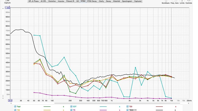

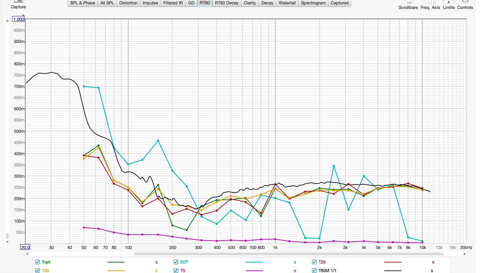

Hi Frank - my big issue is bass overhang in my room. I’m around 800 ms decay from around 20 Hz to around 170 Hz or so.
Hi Aklein55,
Your room is quite dry and rt is more than home theatre dry. Low freq at 800ms is not so bad… if you want to further reduce that. Get some AVAA active bass traps and work with them to further reduce it.
Just make sure you don’t make the music sounds studio dry and not lively energetic. I would recommende less damping and get a bit more diffusion … yet this is only
1 measurement and I haven’t heard your system next to this measurement :wink:
Thanks Frank - I have 4 AVAA active bass traps coming. I’m not sure what I’m doing - so that’s why I hired someone who can help with the room. It’s a bit of a dark science to me.
When you place the avaa, do not fiddle with the knob to adjust the absorption first. First find the spots where they are the most effective by placing them in different locations. Bear in mind they work with the pressure points from your room. Some of them might be 3 feet up. Be creative and let your ears do the work. Play some files with 30Hz - 40 Hz but also some double bass tracks with natural notes. Enjoy the process. It takes time.
Thanks Frank - that’s super interesting. I come from headphones - which have the opposite issue of a very lacking low-end bass response - but a lot of accuracy. I need to find the happy midpoint.
