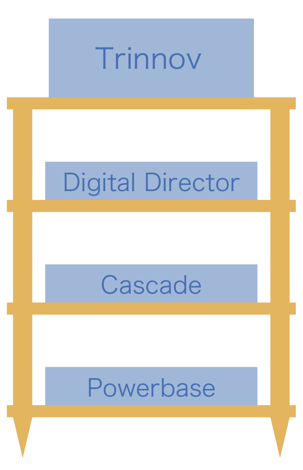

I am designing a HiFi and home theater system, and I plan to use the Cascade as my primary HiFi source. I need to estimate the cable lengths required based on the placement, while keeping them as short as possible.
The rack has four shelves, each with a height of 215 mm. The preamp Trinnov Altitude32 is placed on the top shelf, and the three lower shelves will hold the Digital Director, Cascade, and Powerbase respectively. According to MSB’s official placement guidelines, if arranged in the suggested vertical order, the Cascade would be in the middle (see figure), which means it cannot be connected to the Trinnov with a 0.5 m XLR cable.
Would it be acceptable to swap the positions of the Cascade and the Digital Director? What are the lengths of the interconnect cables provided by MSB between the Digital Director, Cascade, and Powerbase?

Could you please help me measure the length of the connecting cables between the Digital Director, Cascade, and Powerbase? Thank you very much!
I know that there no difference in sound between 0.5 m XLR cable and 2 m, but there is a price difference — the higher‑end the cable, the bigger price difference. That’s why I asked this question, I hope to use the shortest possible length (to save money haha).
The only connections required between the chassis’ is the Summit power cable from the Power base to the Analog converter and the Cascade Link between the Director and the Converter.
The Summit power cable is roughly 32 inches from end to end, but the cable is rather stiff so it is recommended to always keep them directly above/below each other on a rack to keep tension low on this connection.
The Supplied Cascade Link cable is 2 meters in length and is very flexible so it shouldn’t be an issue to move the Cascade Director.
In alternative setups, some customers even remove the Director completely from the rack in favor of having it in an alternate location or closer to certain sources. In this case, the Cascade Link Fiber cable is a simple generic fiber cable that you can buy in lengths up to 1km with no signal loss or degradation and is very affordable. We have a guide about this connection here on our website if you would like more information.
I would recommend moving the Trinnov to the bottom of the rack, or if visibility of its display is required, to the second shelf, placing in-between the director and analog converter.
