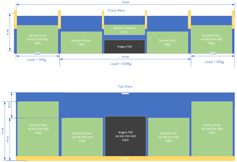

Second should I be fortunate enough to be able to afford the Sentinel DAC, I have some space limitations that I need to address, so this question is hypothetical but rather important as it drives the decision process. I dont have the space to stack everything perfectly with proper separation and so on
My choices are placing the Digital Director on a Niagra 7000 with a wooden shelf 5 cm above the Niagra or placing the Digital Director directly on a REL N0. 31 both of these configurations have very limited separation 5-10cm between the M500 and the Sentinel Power but I will have forced air the other option has a lot of space between the units but I have to stack the Sentinal Power on the Niagra 7000 and the director on the DAC
So the question is which is preferred are they both ok, is one better are they both awful do I need to revisit the approach, etc…

The viton feet have a flat pad area, but the top of the units are sloped. So you will want something very compliant or with a narrower point. The Iso acoustic feet will probably work best. The extra height is also a boon, as it will help with ventilation between the units.
actually if I go with the below there is no stacking but there is only 3cm between the units and only 2 in the middle
The spacers are just for placement, I am contemplating the inflow directly under the units the front 5cm of the tray would be wood and then the rest perforated metal with a diffuser mounted directly under the center of each unit. I would likely use 3 separate inflo motors so each has a thermal speed controller with a min setpoint of 30 Celsius and max setpoint of 45

If I use IsoAccoustic Neo’s under all equipment I think I can use perforated steel shelves for the back 85% and wood for the front 15% this would allow me to use forced air from below , the next question then becomes dispersal pattern, shoould I use a single rectangular ent centered or a series so the entire compunent sits over the vent system, the first will have a higher velocity but a smaller coverage area.
Should I attach the probes to the top (harder) or side (easier)?
Extraction as close to the ceiling (let the air rise naturally) or as close to the components as possible and if so 2 larger units for the cabinet or 3 smaller so they have more granular speed controls?

It’s not possible to figure out cooling without knowing what is behind that wall. I don’t think it will be that hard to do, but it will take expertise.
I don’t think the noise level you are asking for is achievable. Just your HVAC system is good for more than 30 dB. And force cooling the HiFi equipment will probably generate 30 dB noise on its own, regardless of the kind of fan you use.
Fortunately 30 dB + 30 dB is not 60 dB, it’s 36 dB. There is probably a decibel app available for your mobile phone. Use one to get a feeling for the intrinsic level of noise in your room.
