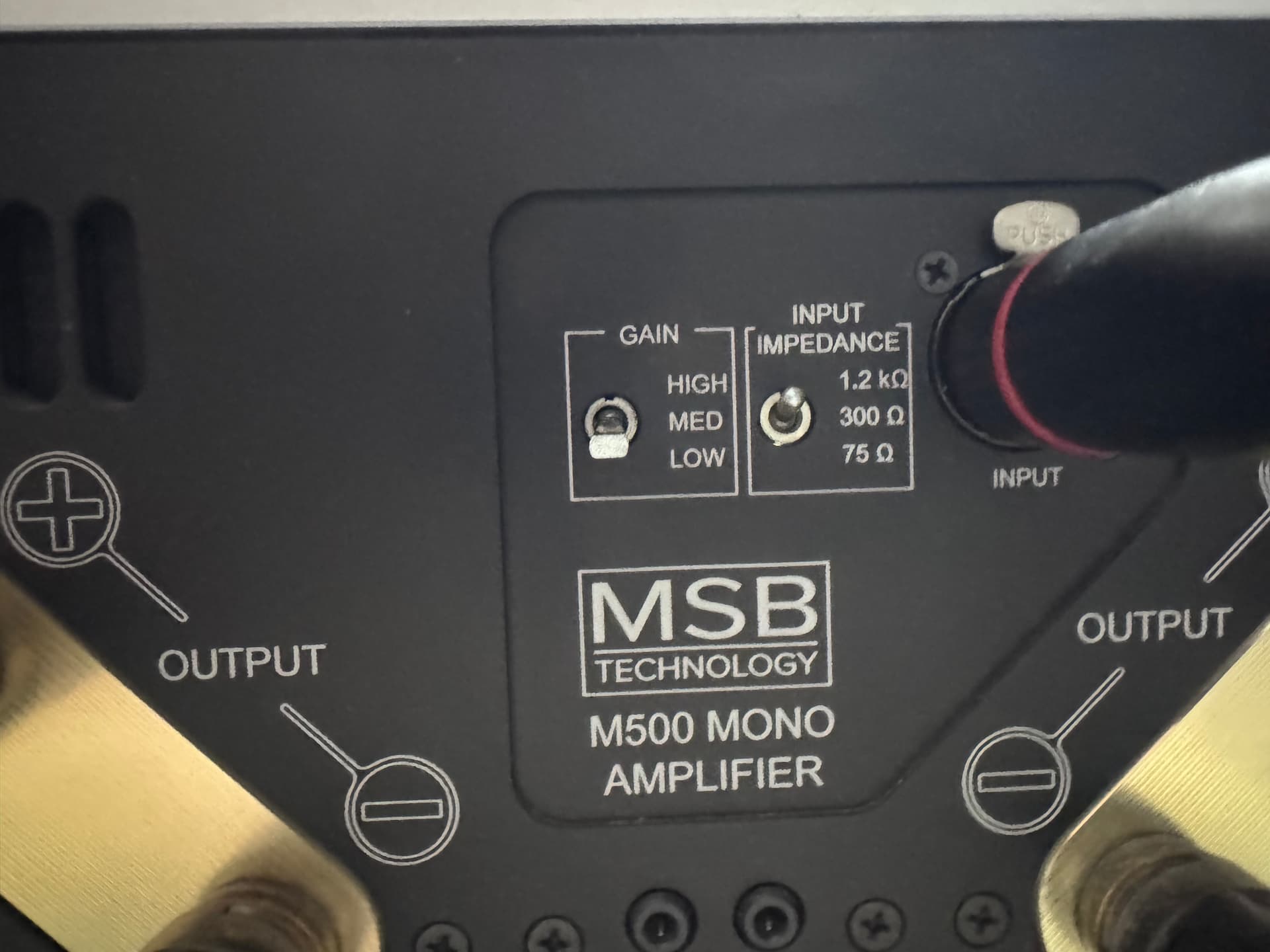

Dear Jonathan, I have a similar question. I run my Cascade via a Vitus MPL preamp to MSB M500s. The Vitus preamp has an output impedance of 80 ohm. Am I right that I should ideally set the M500 input impedance to 1.2k ohm? Would there be any harm if the M500 impedance is set at 75ohm?
Regards
My guess is that the 1.2k ohm setting will be best. It should have no problem driving that impedance.
Most equipment other than ours is not designed to drive 75 ohms, i would contact Vitus if you wanted to set the amp lower than 1.2k.
Hi Dustin,
At 1.2k ohm setting, the M500 sounds much Softer than at 75 ohm. About perhaps 6dB difference. Everything else was kept the same, gain setting at low. I am not a techie. I wonder if you would expect a higher impedance at M500 to sound softer or louder?
The amps impedance switches rewire the primary windings on the amps input transformer (the primaries are connected in various combinations of series or parallel) the amp does not change at all otherwise but will have less gain at 1.2k than 75 Ohms or 300 Ohms considering your preamps 80 Ohm output impedance. This will not be an issue because you are using a preamp for your gain. All preamps I know have plenty of gain and output voltage. If necessary you can also use the amps gain switch to increase the gain of the amplifier circuit (in about 6bB steps).
The exact gain change with different input settings is dependent on the impedance of your source (or preamp). For example if your source is 150 Ohms then switching between 75 Ohm input and 300 Ohm input will result in exactly the same gain for both positions. If that source had a 300 Ohm output then the 300 Ohm position would have about 3dB more gain than the 75Ohm position. Conversely a 75 Ohm source would have about 3db less gain on the 300 Ohm input setting than the 75 Ohm input setting.
Our amplifiers (unlike most others) essentially amplify the input power, not the input voltage. So 75 ohms being driven by a 300 ohm source results in less power transfer than a 300 ohm source driving a 300 ohm input. In fact maximum power transfer (therefore maximum gain) happens when the source and input impedances match. So a low impedance source (eg. 80 ohms) driving a high impedance input (eg 1.2k ohms) will have lower gain.
Thanks Dustin for your detailed explanation. If I understand correctly, I should expect to hear a lower gain using the 1.2k ohm compared to using the 75 ohm with my preamp source of 80 ohm. If so, may I know why there is a general recommendation to use a higher impedance eg 1.2k on the amp? What is the benefit or advantage there in terms of sound quality?
1.2k is an easier load to drive and your preamp is less likely to clip is my understanding. The only time a lower gain is an issue is if your preamp reaches 100% volume level before you’ve reached an acceptable listening level.
Hmmm.. not sure how that applies to MSB amps. At 1.2k, I find I lose about 6db of gain and volume so I have to crank up my preamp. It feels like a harder load to drive ..
Much easier to drive at 1.2k, just a bit less gain for low impedance output preamps. The 75 ohm input setting needs to have the manufacturer of the preamp OK the low impedance because it will seriously stress a lot of output driver designs.
I am sorry but I still don’t get it. If 1.2k is easier to drive, why would it result in less gain? Wouldn’t it be louder instead of softer? :face_with_monocle:
Let me explain. It is much easier to lift your car using a floor jack that takes several pumps of the handle to lift it than to lift your car using only your arms. The jack is easier to use but requires more pumps of your arms (low gain), the brut force approach would lift the car faster but be much more difficult (high gain). The 1.2k setting is easier to drive (less current flow) but requires more voltage. The 75 ohm setting is much harder to drive (more current flow) but requires less voltage. Both settings require the same total power input to result in the same amplifier output. This is because power is equal to voltage times current flow.
To reach full rated power on medium gain (500W into 8 ohms) a 500 series amp requires about 40 milliwatts of input power.
I happened to talk to the designer of Vitus preamp. Like me, he had expected the 1.2k ohm input on the M500 to sound louder than the 75 ohm input, when driven by the 80 ohm output of the Vitus preamp. That being said, he also recommends 1.2k ohm.
The confusion probably comes because most amplifier designers expect amplifier input stages to respond to voltage only. He probably thought that the different impedances were resistors slapped onto the input, therefore a 75 ohm resistor would eat up some of the input voltage, due to the voltage divider effect, lowering the input voltage and making the result quieter. But thats not how the MSB 200 and 500 series amps work. The inputs respond to power ( voltage times current) not voltage alone.
With my Vitus preamp fixed at 80 ohm output, if I wish to have more gain, should I try to lower the M500 impedance from 1.2k to 300, or to increase M500 gain setting from low to medium to high? Or it doesn’t matter which approach . I am inquiring from a SQ and technical perspective. Thanks a lot.
If your using your preamp I would use the gain that it provides. Thats the whole pont of a preamp. If you aren’t at full volume on your preamp then listening I would keep the amp at 1.2k. If you need more gain use the gain switch on the amp.
If you don’t like the sound your preamp provides then remove it.
