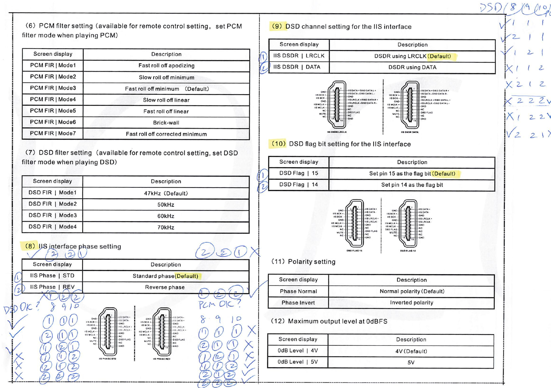

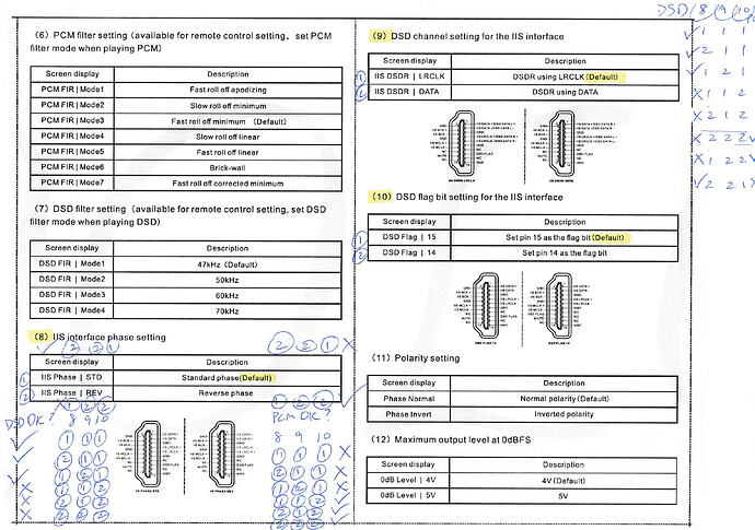

Posting the following example to help understand the challenges of making I2S connections fully compatible between DACs and CD/SACD transports.
I was curious whether the PS Audio transport’s I2S output would connect with the Topping D90 MQA DAC to work seamlessly. The diagram below is quite complicated, but I was trying to find a particular pin assignment setting in the Topping DAC which would enable automatic playback of PCM and SACD.
Note the bottom L section of the page - one column is for PCM playback, the opposite column is for DSD playback. “Check” indicates compatibility, “X” indicates no sound.
Unfortunately, there were no settings on the Topping DAC compatible for both PCM and DSD playback on the PS Audio SACD transport. Such is the complexity and randomness of the pin assignments, because there is no industry standard.
BTW, I’m an owner of the MSB Cascade DAC (and soon, the Sentinel DAC, for which I will be connecting the PS Audio PGM Signature SACD transport). Thankfully, compatibility between the PS Audio SACD transport and MSB’s I2S input module is assured, so I’ll have no problems with the future playback of both PCM and DSD!
I don’t think you can make it work with DSD as the PS Audio won’t output the DSD unless told to do so by the DAC.
