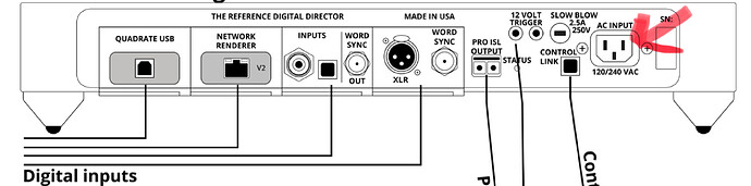

@Daniel_Francis please can you confirm us the right pin IEC scheme of:
S202 (new 2023)
Reference PowerBase (new 2024)
Reference DD (refurbished 2024)

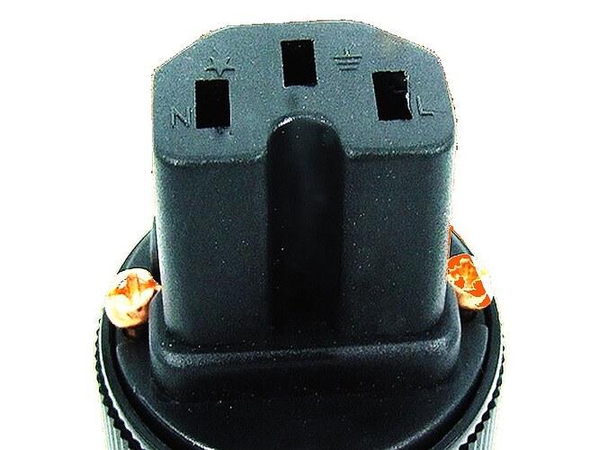

Looking at the cable the phase is always on the right, according to EU rules, like in the pics below (the hole #1)
Can you confirm that this orientation is compliant with IEC sockets of MSB devices?

This is the “normal” for IEC connectors (L is hot). However, as you have pointed out, the Schuko plugs can be plugged in either way, so we designed our equipment to work either way. They are all designed the same, so I do recommend making sure the phase is the same between all the equipment.
In our listening room, we run 240V, so both of our phases have power on them (120V out of phase). We match the phases so the equipment is all the same.
